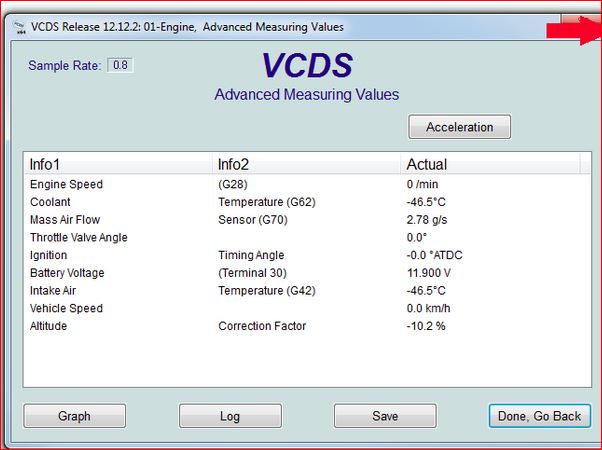

Hi!
I made LOG "Advanced Measuring Values" by VCDS 16.8
This picture for example, not my.
This log impossible open in Dieselpower LogView (0.1.6 )
:o
My Log here
https://yadi.sk/d/TF0Pa9fewzDCL
